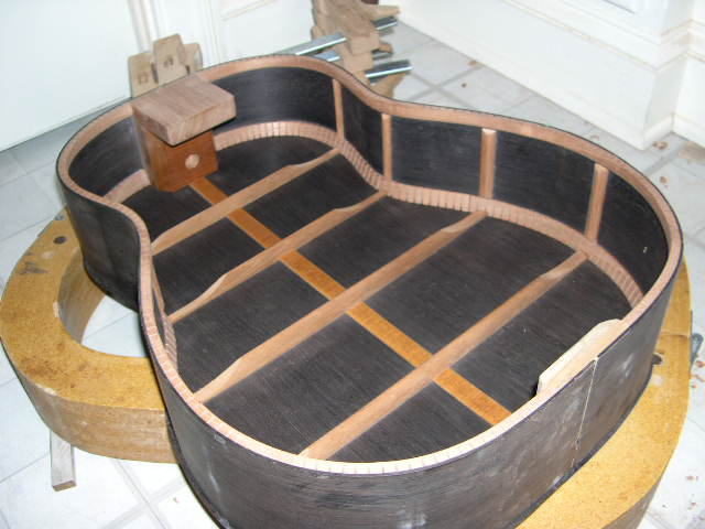

I have been taking a cue from Ervin Somogyi lately, who--as of our last conversation--liked to keep the species the same. And I mean by that the same species of the internal wood. So, if he used mahog (or Spanish cedar) for linings, he would use mahog braces, head block, etc. A visual thing. Everything matched everything else. Presents a cleaner appearance for those who like to peek through the soundhole.
Here's one I'm doing in African Blackwood:
It uses Spanish cedar for the linings, Hond. mahogany for everything else. Oh yes, the seam reinforcement strip is French polished.

Steve, that is very clean looking.I like the french polished strip. I noticed the horizontal neck support on your neck block, so your top surface is flat in that area? I like your reversed linings on top also, you make your own? Clinton
PostPosted: Wed Mar 01, 2006 3:06 pm
Thanks for the kind remarks, all.
Clinton, the block is curved to match the radius of the top. But in a piece that's only 3" wide, it looks flat. And I use a 25' radius on my tops, which isn't as flat as some. And yes, I do make my own linings. I left the "web" thick enough on these so that they had to be bent to fit the sides. But that really makes a stiff construction. I used triangular on the bottom for convention's sake.
